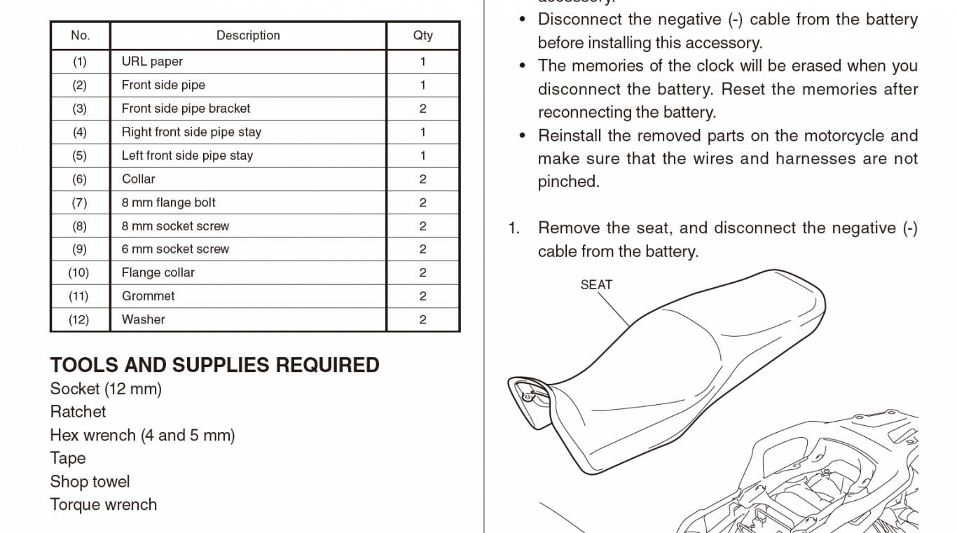

    I’m new to the Crosstourer world and just trying to figure out a few of the basics!
    Do I need some different engine bolts in order to fit the crash bars in the correct location? The bike didn’t come with crash bars, I bought them on eBay  (just 2x brackets and 2x bolts for the front end were included)
    I’m aware that the current setup is incorrect but it’s the best I can manage at the moment!
    Any help would be greatly appreciated, thank you 🍺

    Below are the details of the hardware required:
    Last Edit: Sep 11, 2021, 03.35 pm by Mav

    Thanks a million Mav, that’s fantastic and very much appreciated!
    Happy riding 👍🏻
