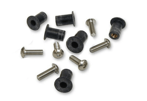

    Not so much the screen as the little rubber well nuts that hold the screen on....
    Over time, with changing screen etc, the little rubber grommet thingies that hold the nut have ripped or broken apart
    Ive used Fleaby and bought Rubber Well nuts with M5 screw (listed as for fairing use) see pic belowbut only have one end flange not the double ring rubber think
    Make sense?  LOL
    Any ideas where I can get replacement double rubber thingies?
    I've looked on Honda micro-fisch exploded parts diagram and even on there the right parts dont show
    At the moment, I can refix the screen
    Bright ideas?

    You meant these? klik
    On the 2016 they used normal wellnuts.

    I think what you are referring to as a 'double end' is the result of the well nut being 'screwed up' tight
    for a long time.
    Over a period of time they lose their ability to return to their original shape.

    Yep - nut inside the rubber gets pulled a tad further up and hence you get the second bump ... as DE65Y says!!

    Click on the link i posted before.
    There is a type witch has a bulge in it just to give it a bit of pre lock and to prevent in from falling out when it's upside down.
