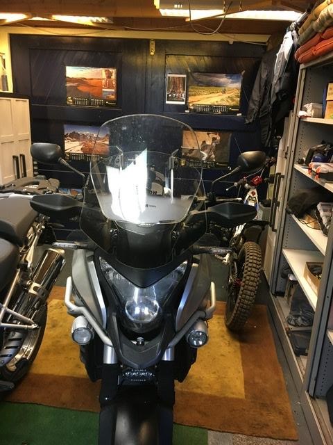

    Ik could feel that the windbuffeting is coming from the narrow part in the bottom of the screen. It is so narrow because there must be room for the handguards at full lock. Didnt want to give that up. But it got me thinking. Taped the screen up with cardboard and ducktape and it does result in a bit less windbuffeting. So a wider screen below the airflow topscreen could be the solution. But a bike that has room for any steering angle is probably a good idea.  :192:
    If i can place the screen a bit more forward and the handguards a bit closer tot the handlebars it could make room to fit a wider screen.
    I found the palmer products brackets, and the givi airflow screen for a DL650 2004 (44cm wide!) wich gives me almost infinate screen angle and hight options. Had to dril 4 new holes to fit the screen.
    I got a 5cm gap behind the window which eliminates a low air pressure zone behind the screen and more room for the handguard.
    I got some second hand versys 650 barkbusters and made them fit. Cut of the original mounting bracket from the left side handguard and removed the plastic housing from the frontbrake.
    Now i have full steering lock and a completely windfree pocket up to 140kmh. Even without my tankbag.  :788:
    Nice bonus, i can look over the screen and not through it wich i find terrible on winding roads.
    Even croswinds dont have as much effect as before. Only stormy sidewinds spoil the fun now.
    Now it is the perfect comfort bike for me. I would say, if i can ride with this setup, most people would be very happy.
    Im 1.82m in length with the normal touratech seat. The bracket and airflow screen are in the lowest setting for me so about 20cm of room to play with.
    So in conclusion my setup:
    Givi airflow screen suzuki DL650 2004
    Palmer products crostourer brackets
    side wind deflectors
    diy fork tunnel blockoff from this forum
    Put up the links and some pics below.

    adjustable bracket: http://palmerproducts.co.uk/
    givi airflow dl650 2004:
    wind deflector francesco cuomo: https://www.crosstourer.com/index.php/topic,2835.144.html
    email: francesco.cuomo66@gmail.com
    diy forktunnel cover
    https://www.crosstourer.com/index.php/topic,2835.168.html

    buffeting gap:

    dl650 givi airflow baseplate:

    palmer brackets:
    DL650 givi airflow mounted on palmer brackets

    looking nice, even if it is big, but if it helps a lot and improve riding time and fun. Then I would do that to.
    Only thing I would do, es to get rid of the white color of the Give airflow screen on top.
