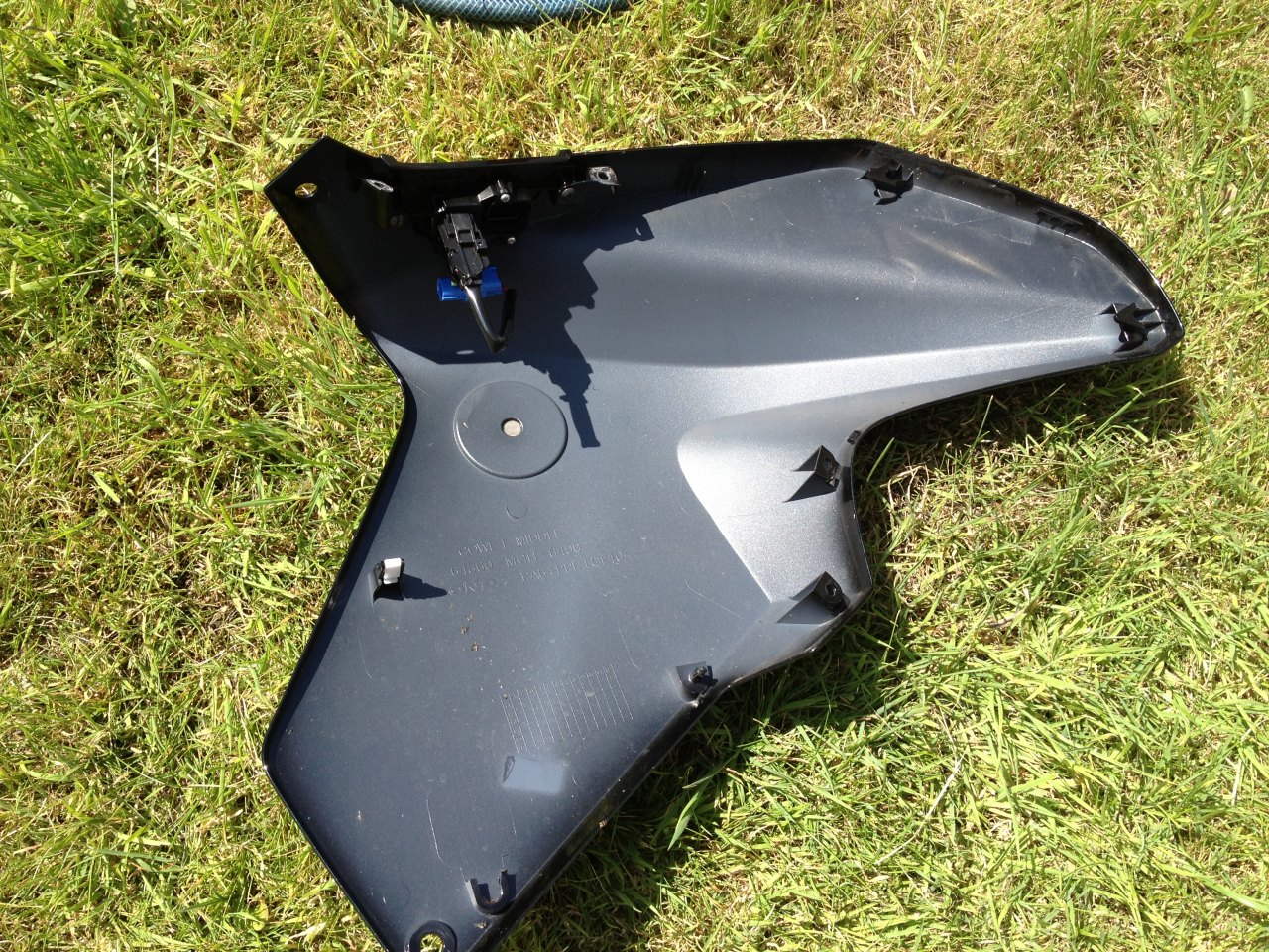

*Originally Posted by biker1300 [+]
Has any one done a pictorial how to remove body work yet ?
The most important thing to remember for the sidepanels is once you have undone the bolt,pushed the poppits out, uncoupled the TC switch and brought the side panel out a little is to push the sidepanel to the front of the bike.
That pic is a LHS panel, the final two tabs that you push forward to unhook are top right.
