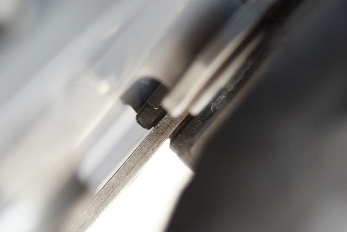

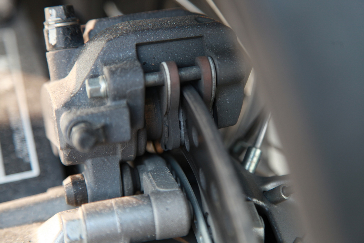

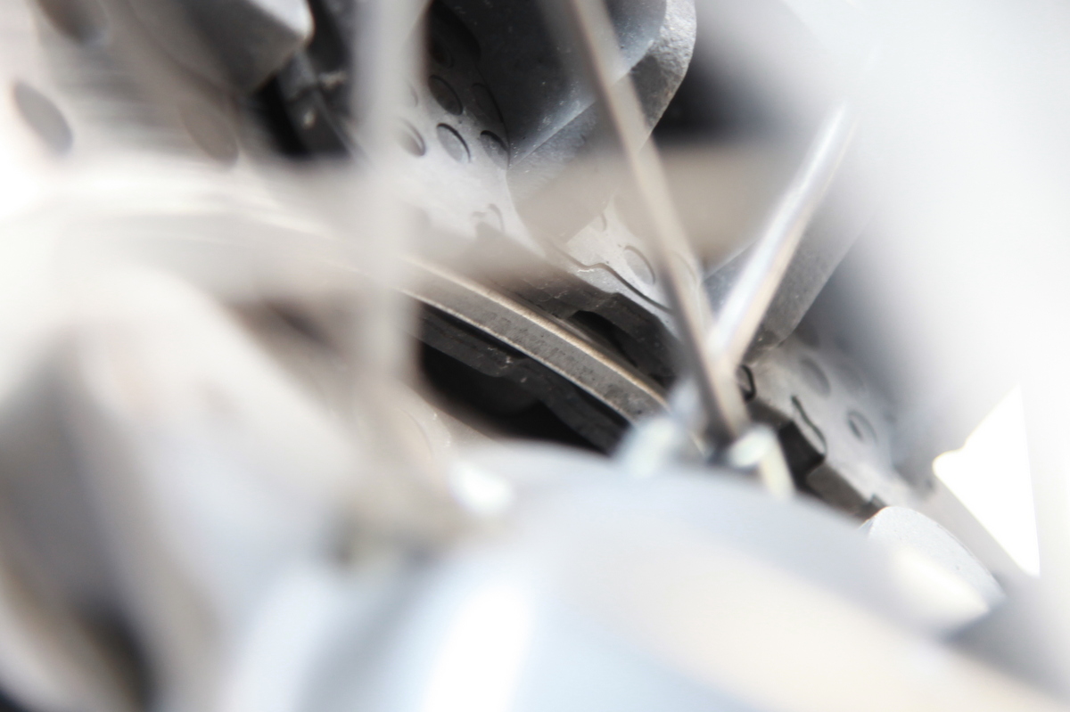

I was about to change my front brake pads. The front left looks like it's about time to replace. Open it up, there's some left before the marker.. Hehe.. feeling cheap, I think I use them for a little while longer (will check them everyday).
I just clocked 20,000km on the CT. The rear was change once on 11,000km. I think, my usage gonna be 1:2 ratio for the fronts and rear. How about you guys?
Here's some pics :
Front left.
Front right.
Rear.

Strange thing is after a new set of tyres the other day I inspected my brake pads and also noticed the left outer pad was worn more than the others.
The bike has only done 6k miles so was surprised as normally I would expect a lot more out of a set of pads. She's a heavy old girl and mostly used for commuting into central London though.
Do you think the uneven wear is down to the linked braking system ?

I think so. There are two separates brake hose for the left caliper. I couldn't remember where I read it, but the only upper left piston trigger with the rear brake. It's a different system such as from Super Tenere.
I think the OEM brake pads are soft, but it's good, but not economical. But wondered so much since my VFR1200 rear pad (shares the same P/N) lasted a lot more than this.
