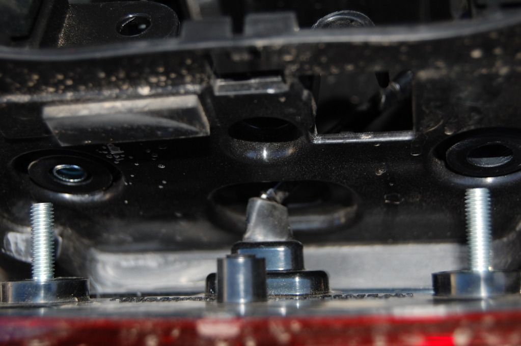

Decided to take the little bugger in bits as its to hot to ride today 36 Deg
You can see from the pictures in the two bottom corners where the light assy is banging, and strange to have one piece if rubber strip at the top and not the bottom???
Maybe my little Asian friends forgot to put them on??

Hi, took my stuff off to have a look after work today...jeez bit of a drama but you live and learn
anyway mine looks exactly like yours, not entirely happy with the padding although I see that the holding screws and grommets look to do the job
banging on plastic over hard bumps doesn't sound good though and if I tap it hard enough it does the same as yours in the vid, maybe a trip to the hardware store for some weather seal ~ sticky sided foam to stop it banging on the bottom?
I wondered why the rubber or foam pad on the top left isn't on the top right but i see under that pad is a slight step out to harbour the rubber but no step out on the top right – there must be method to their madness because they did that during the manufacturing process
jon

I noticed exactly the same thing on my bike. Took a while to track now what the knocking was.
Had a quick look at it one day and decided getting at it was too much of a pain so I just cut up a piece of old bike inner tube folded it a couple of times and stuffed it in the gap under the light. Seems to have done the trick :047:
