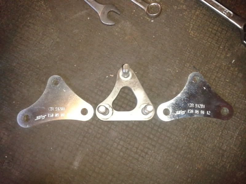

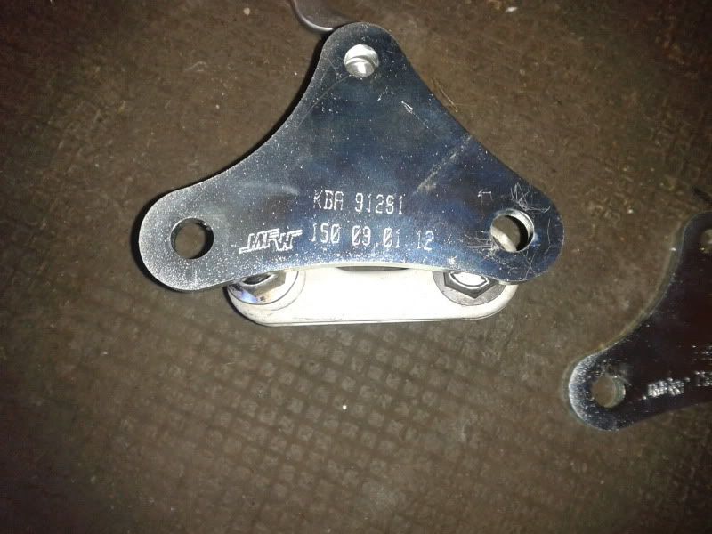

Well guys I've been to whitby for fish and chips today (310 miles round trip) and i can report that the lowering plates are not without issues :084:
I had been in touch with a manufacturer about making some for other members (the short arsed ones) at a much more reasonable price than the £59.95 i paid (probably £30) but production is on hold until a ground clearance issue is resolved. I have bought dogbones for my TRX from this firm for under £30 that give 4 ride height options so i know the engineering is spot on and they are very well respected people on the www.trx850.com forum.
They are going to produce some with a 15 or 20mm lowering for me to test ride before production and i will report back in due course
Because i dropped the rear by 30mm i let the forks up through the triples by 25mm as well to balance both ends up and i think the combined amounts have proved just too much for such a big and heavy bike with a centre stand fitted (came with the SE package) so my first job is to remove the centre stand and test ride to find the new limits of lean
Wish me luck
Ian
here are some pics (sorry, i posted them upside down :156:)
