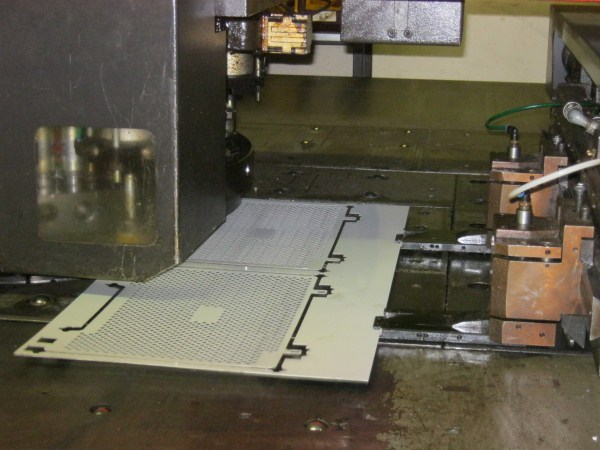

However, since the change was pretty simple, it didn’t take long to get the punch set up to make the new blank, or rather a pair of blanks:

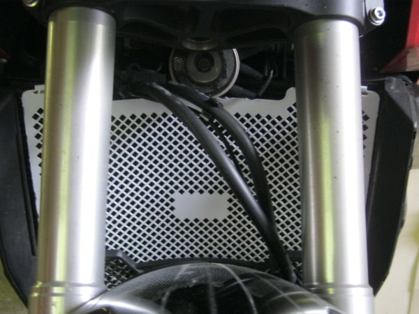

This was then offered up to the bike and it became clear what a bunch of perfectionists these guys are because it sat about 2mm off centre with a slightly bigger gap on the right hand side than on the left.  Not good enough, they said:

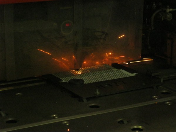

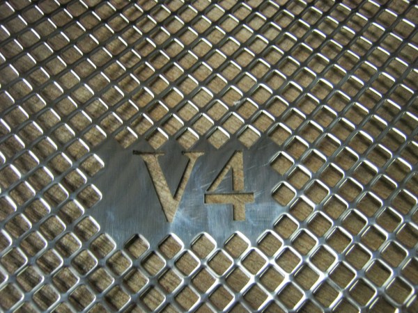

The drawings were altered to shift the mounting holes and another pair of blanks was made.  This was a much better fit.  Next up was the logo for the centre spot.  Alas, their graphics man is away on holiday, so copying the “X” logo and converting it to the right file for the plasma cutter to work with wasn’t going to be possible.  We played with a number of existing X logos, but none were anywhere near right, so in the end I opted for a simple V4 logo, which the plasma cutter soon created for us:

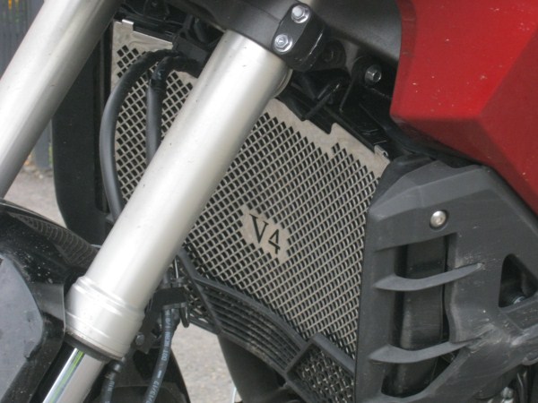

However, general opinion was that the logo wasn’t correctly positioned, the lettering being too close to the grill area:

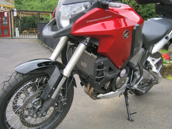

So the drawing was changed again and another blank was plasma cut.  This time, the logo is much better placed and we were all happy.  Here’s the finished product, which I think looks great and should give plenty of protection for many years to come.  Well worth a day out to be their test mule!

Yes!  You have to remove the plastics off the sides and bottom, but that’s just the allen bolts and a few plastic clips.  The guard then clips on at the top (the guard is made specially to fit) and two bolts replace the 2 plastic clips at the bottom so it is held top and bottom.  The side plastics then just go back on over the guard, no problem.
